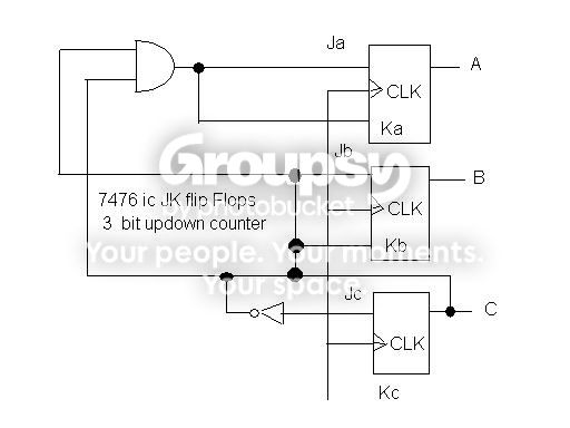

hello there mga masters question lang po if tama po ang schematic diagram ko para sa 3 bit binary up down counter with jk flip flops... e2 po image....
thanks in advance...

anung type ng counter gusto mo... ripple or synch... what? Mali yan

gamit ka nalang ng circuit design simulator para malaman mo
