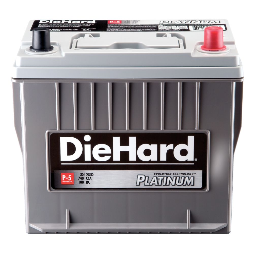

« Reply #8 on: June 01, 2011, 04:47:35 AM »
battery ba? die hard na!
