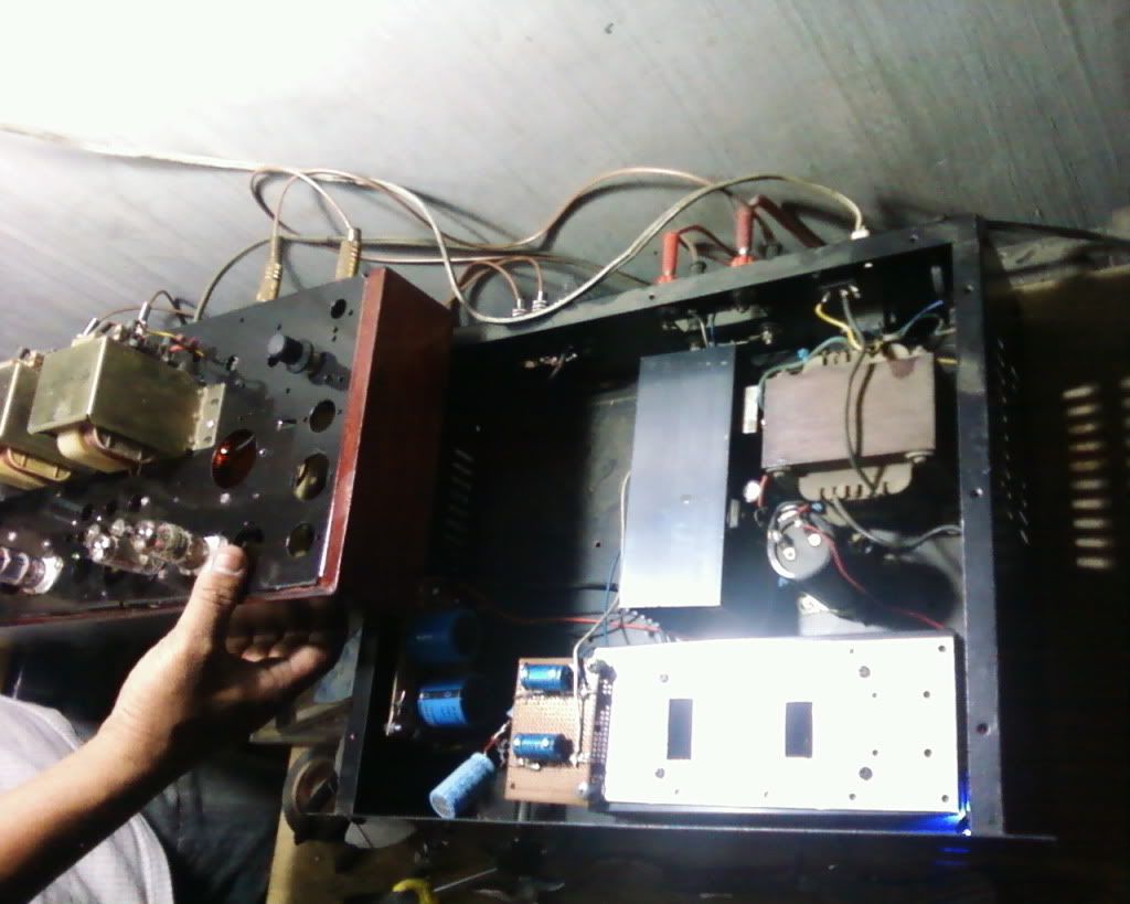

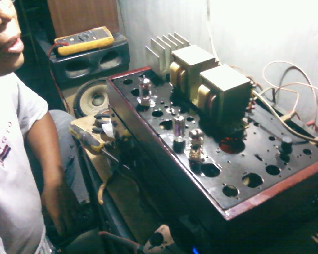

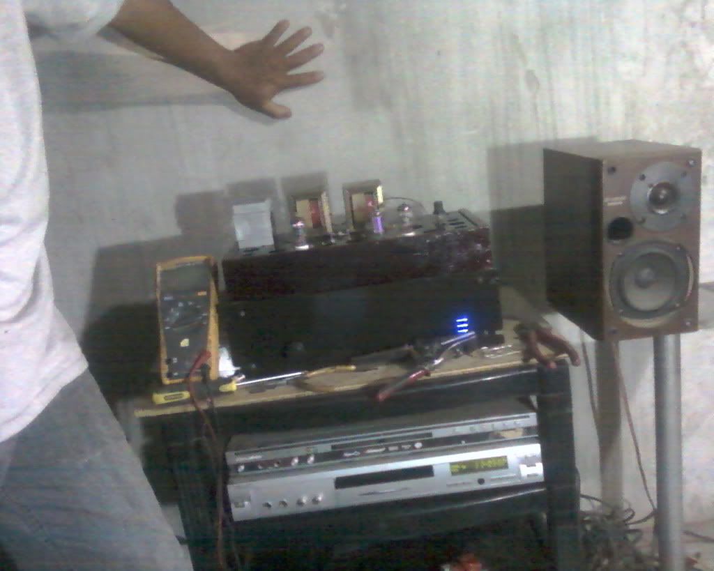

Some old pics for the Dellepiane amp. I have also built the Hiraga & JLH, but after my wife complained about the unusual heat in the room & the unexplained sharp rise in electric consumption, I opted for Dellepiane, a flea power class A amp, but not an issue since i'm using a high efficiency loudspeaker 95dB typical, more than enough in a 4meters X 6meters room. idling at 700mA the heatsink can be touch w/o the "ouch", compared to JLH idling at 3.5A, is enough to cook an egg in the heatsink :o I almost forgot the pix....
pardon the fuzzy celfone pix
driven by a tube pre-amp for that "warm & sweet sound"
