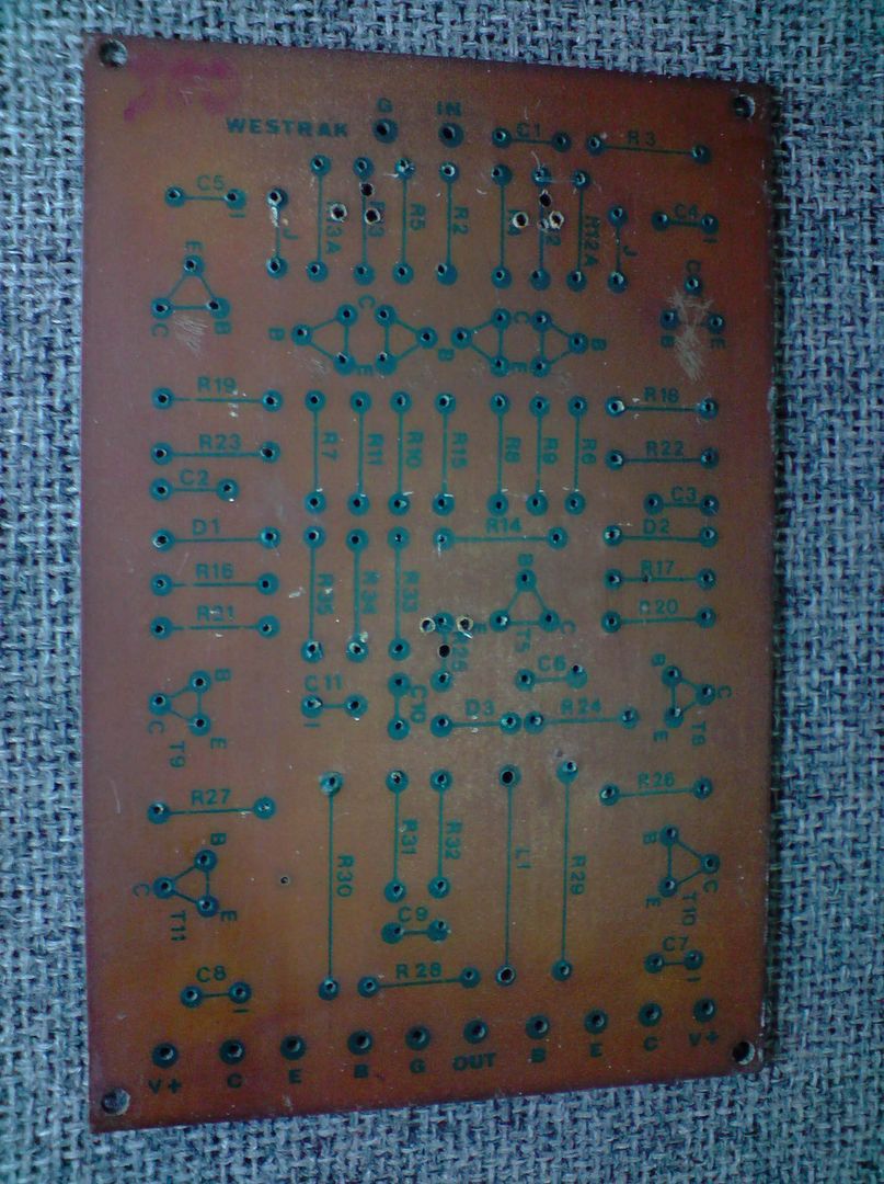

westrak ang pcb nya.maganda din i-clone ito dahil maganda at stable ang pagkagawa.

clone lang din yata yung melody amp na yun

« Reply #7 on: October 09, 2011, 08:14:52 PM »
ung 2nd pic , westrak ata.

« Reply #8 on: December 14, 2011, 12:33:38 PM »
Oo, yan yung inalok nyang pcb sa westrak thread.
