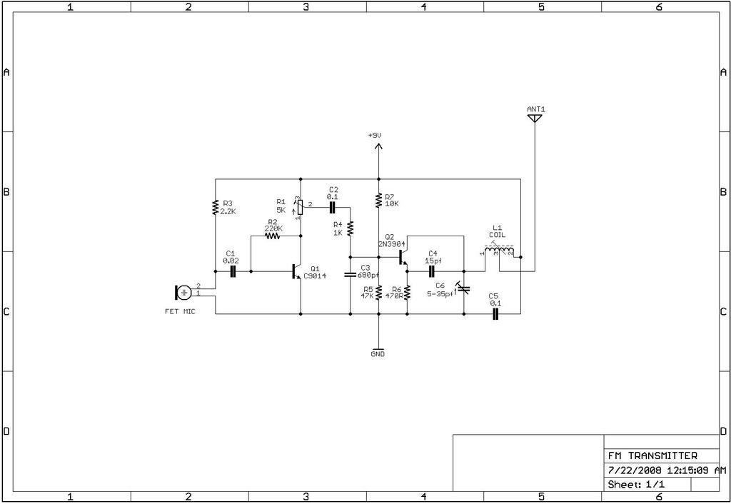

Try mo to FM transmitter (Range 20 meters Max.)
